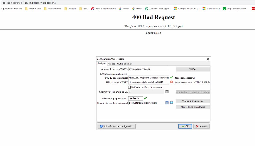

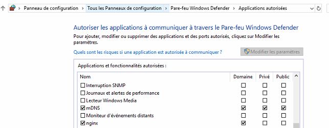

I'm writing this email because I previously used WAPT with a Windows 10 client session, but now I'd like to run WAPT alongside WSUS and therefore IIS. (I don't have the budget for the enterprise version for managing Windows updates, I should mention.)
However, I'm struggling despite using the FQDN, static IP, IIS, adding the new site, and even disabling the firewall; still nothing, I can't start the console
I followed this procedure but it doesn't work (just changing the port to 8082)
https://www.wapt.fr/fr/doc-1.3/Installa ... index.html

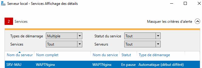

Furthermore, in the service
I think there's something I don't understand
Thanks in advance

Good morning
Thanks for the info, I'd actually seen it in an ANSSI PDF
But
So I'm following the procedure: net stop WAPTGinx
net stop waptservice
OK
listen 80;
listen 443 ssl;
by :
listen 8000;
listen 8443 ssl;
OK
And it still doesn't work, with an error also on the certificate, plus IIS is still not activated in service.
Thanks in advance

Is the "waptserver" service running?
If it's not running:
Reinstall as a local administrator.
