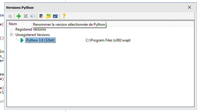

When editing in pysrypter, it's always in Python version 2, while WAPT 2.0 uses version 3, which I don't quite understand.

Regarding editing via PyScripter, your problem may be related to a simple display issue. WAPT 2.0 does indeed use Python 3. It's also possible that you have some remnants of Python 2 on your machine.

If you previously had version 1.8, it's possible the name in PyScripter hasn't updated correctly. You can check in PyScripter by going to "Run" -> "Python Version" -> "Set Python Versions"; you should find the path to the WAPT installation folder there.

For Python, it's strange:
I'll let you see for yourself:
https://imgur.com/AskZTkg
I have two versions.

First of all, a big thank you for your feedback.
The silent options are correctly entered in setup.py, maybe I made a mistake or an error.

For the Python version, it's just a problem with the name display in PyScripter. (You can rename it manually in PyScripter and name it wapt.).
- Attachments
- renomer.PNG (12.92 KB) Viewed 12440 times
Thanks to Pyscrypter, it solved my problem.
