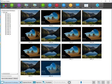

However, the workstations are indeed accessible via Veyon Master or by directly entering the IP address into Veyon:
veyon 1.jpg (47.33 KB) Viewed 3931 times
So the problem lies with the console.
