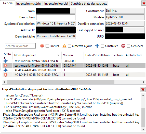

For a project during my second-year internship in computer science (BTS program),
I implemented the WAPT solution on a Windows 2016 server.
I installed a Windows 10 client with the agent and then I created my own Firefox package using an .msi file.
Once the package was created, I deployed it to the client.
The package deploys correctly on the client, but on the server, it throws an error during installation and from what I read, it's a problem due to the uninstallation key.
That's why I modified it in the package's Python code
but despite that the error is still present, I wanted to know how I can fix it.
Thank you for your help.
P.S.: I'm a beginner on Wapt and I'm not very good at Python.

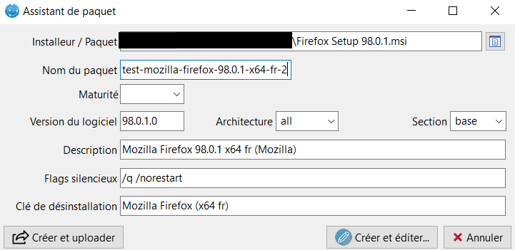

If the default uninstallation key in the .msi package is incorrect, then I don't know if the modification I made in setup.py is correct or not?
Here is the setup.py file for my package:

According to the list-registry, the uninstall_key is: "Mozilla Firefox 98.0.1 (x64 fr)" (see uninstall_key column) and not "Mozilla Firefox (x64 fr)"
And it needs to be passed as an argument to the msi function (if the key in the msi is faulty).

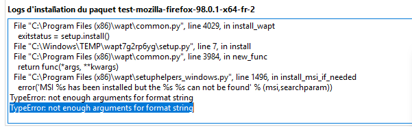

I've switched to WAPT Discovery version 2.2.0.11720 and when I used the code snippet you suggested last time, I got another error.
So I wanted to know what might be causing it.

Hi Mathéo,
thanks for your post. There was a bug in the `install_msi_if_needed` function when the MSI file was corrupted (which is the case with the Firefox MSI). A fix has been implemented and will be available in the next version.
Simon's command line should work for the installation. That said, I recommend using the Firefox installer executable instead; it's less buggy.
Best regards,
