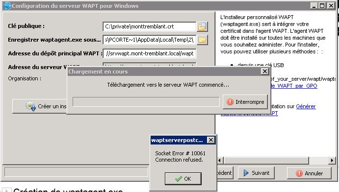

Socket error #10061 Connection Refused.

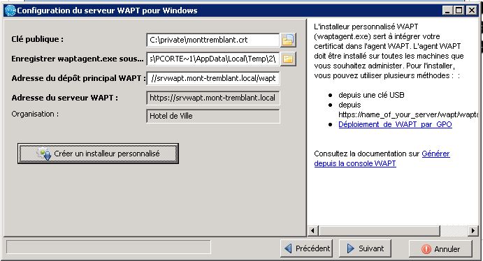

So in the end, I completely uninstalled everything, reinstalled using the default settings, and when I click "create installer," here's the result in the image
Thank you for your help.

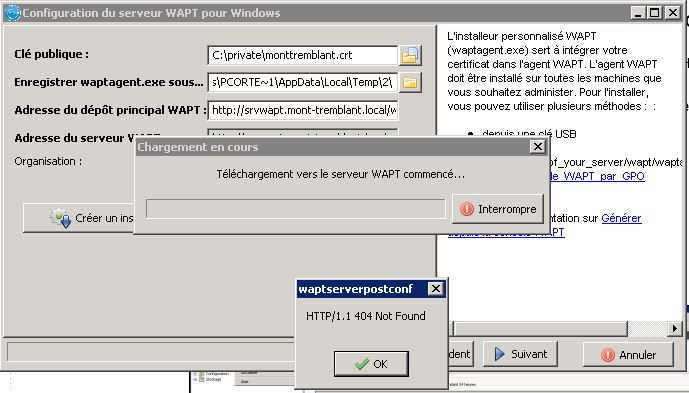

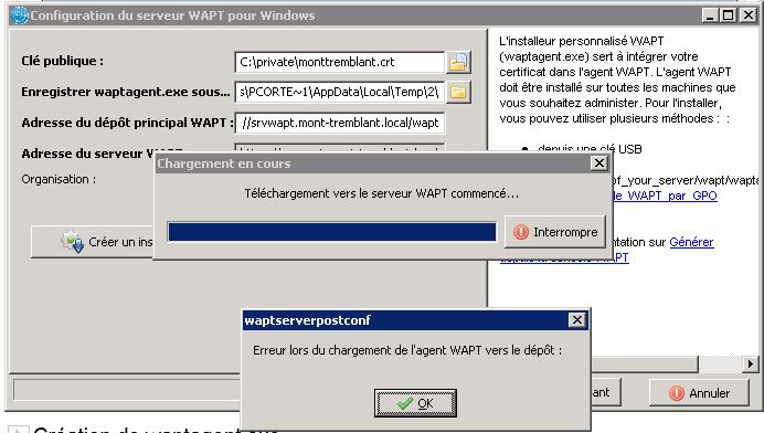

December 16, 2015 - 4:06 PM
If I configure it as shown below, I get 2 error messages:
