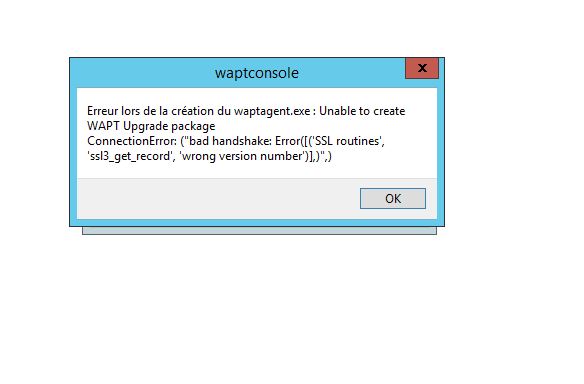

I get an error message when generating the WAPT agent.
It does ask me to authenticate the key with its password, but I get the following message:
Any ideas?

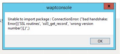

Furthermore, this might be related; if I try to download a package via internet import, it tells me this
He can see the packets on the internet just fine, though.
For your information, in the local WAPT configuration, I have the same problem whether or not "Verify the server's https certificate" is checked.

Hi,
we had the same problem creating an agent.
I disabled the proxy for accessing the WAPT server.
The agent was created directly.
I hope this is a good solution.

Yes, the track is correct. :) Everything is working now, thank you again.
