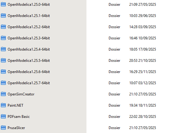

The OpenModelica installer is published for each sub-version, for example:
C:\Program Files\OpenModelica1.25.0-64bit
C:\Program Files\OpenModelica1.25.1-64bit
C:\Program Files\OpenModelica1.25.6-64bit
C:\Program Files\OpenModelica1.25.7-64bit
However, only one entry is registered in the registry for the uninstallation key.
I suggest modifying your package to run the uninstall() function before installing the new version.
It would also be possible to check the major version and only uninstall the folders corresponding to the version to be updated—in this case, all folders of the type:
C:\Program Files\OpenModelica1.25*
Thank you in advance.

If I understand correctly, the problem is that the software doesn't differentiate between installed versions at the registry level, but instead installs different folders for each version, and these folders remain after each upgrade?
=> That's right.
So I ended up with about ten sub-versions installed, totaling approximately 80 GB. The program changes folders with each sub-version, but it only creates one entry for uninstallation…
I don't think the setup allows specifying the installation folder.
See the screenshot.
Indeed, I think the simplest solution is to uninstall all the non-major versions.
We can potentially base it on the control file section, for example:
version: 1.25.7.0-8.
We then retrieve the major version 1.25 from 1.25.7.0-8, and then list the folders corresponding to:
C:\Program Files\OpenModelica1.25*\.
Then, as with the uninstall() function, we can execute run(f'"{makepath(folder_path, "Uninstall.exe")}" /S').
I just tested OpenModelica-v1.25.7-64bit.exe /?.
It doesn't display any installation options, but we can clearly see in the window that a different folder is created for each version:
C:\Program Files\OpenModelica1.25.7-64bit.
No documentation seems to mention an option to enforce a common folder for each installation…

- Attachments
- openmodelica.png (20.22 KB) Viewed 17948 times
