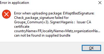

I'm trying to modify a package group on another PC which contains waptsetup.exe and has the same private key as my WAPT server, but I'm getting an error: [error message here].
Do you know what causes it?

Based on the error message, it seems the package isn't signed with a recognized key or is incorrectly signed.
I didn't quite understand everything, but:
You mentioned waptsetup.exe on another machine. I think I understand that you installed waptsetup.exe on another machine to access the console (waptagent is sufficient; all machines have the console).
Try reinstalling waptagent.exe instead. It contains the keys you need to verify the package.
Be careful not to create multiple keys, as you risk confusion; reuse your existing keys.

I used the console via waptagent.exe, but the same error occurs whenever I try to remove a package from a package group. I think I've missed a step; do I need to do something on the server so it recognizes the administrator's machine key?

Hello Martiny,
In the SSL folder on my machine that I want to make an administrator account, I only have the certificate for my server machine's key
