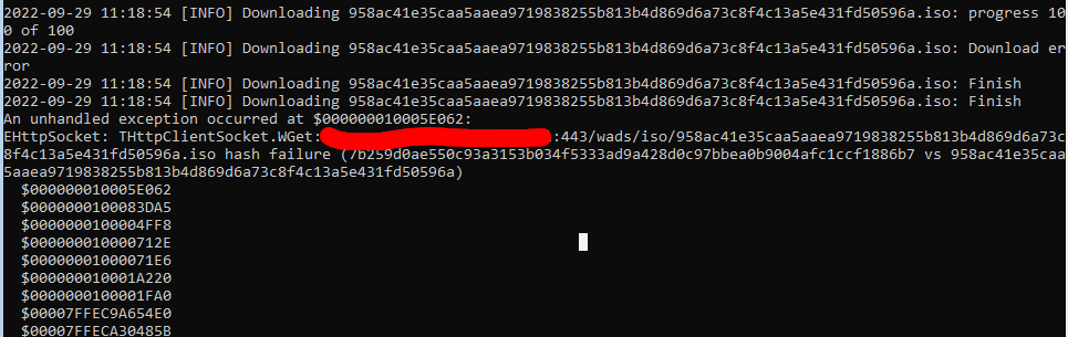

Your screenshot shows a 4.1 GB ISO, not 16 GB as in the previous logs.
Is this an ISO that was modified to be 16 GB?
It's possible that it won't work either, because file uploads go through the /tmp directory of the machine, and if /tmp doesn't have enough space...

Hi Simon,
Yes, yesterday I encountered a disk space error. After fixing it, I re-imported the ISO, which is 12.8GB (yes, a modified ISO).
The download stopped at 100% with the following error: [Error
message here]. So I deleted the ISO and added it again. I just restarted the Nginx service. Is this the correct method to get a consistent hash?
Thanks in advance for your feedback.

- WAPT Expert
- Messages: 2380
The hash is still incorrect.
At worst, you can transfer the file using WinSCP and then rename it.
We're running tests here by uploading very large ISO files to see...

Thank you for your feedback.
Yes, indeed, after analyzing your topics and the Windows 10 answer file, I noticed your configuration.
I'm currently fine-tuning the file, but the ISO is already downloading correctly, which is a victory in itself.
