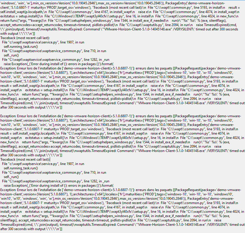

I'm contacting you again because I have a problem. I created a new package for a program (VMware-Horizon-Client-2303-8.9.0-21444108 (1).exe), but when I run the update (package installation), I always get an ERROR error.
I would like to know if there is a way to install this program or another one without having to go through the steps (clicking "Next" or "Install and Accept").
Server: WAPT Enterprise 2.3.0.13516 on Windows.
Consoles: Windows 10 & 11.
Infrastructure: Windows

upon reviewing the logs, we see the message "VMWare-Horizon-Client-5.1.0-14045148.exe /VERYSILENT" timed out after 300 seconds...
Have you tried running the command line manually to see what happens? WAPT makes it easy to package silent installations, but the installation must be silent to begin with.
When using the wizard, it tries to guess what type of installer is being used (innosetup/nullsoft/msi, etc.) and set the corresponding flags, but if the wizard can't find it, you'll need to do a little research on Google... A search for "vmware-horizon silent install" returns the following as the first result: /SILENT /NORESTART...
WAPT tries its best, but it can't do everything and it can't replace a minimum of research to ensure that software is silent in all cases.

The problem is that I've already searched extensively but it's not working. I tried running the command line manually on the client machine, and I found that it works, but for 100 computers it will be difficult to do it on each client. What's even worse is that the server sees the program but doesn't check for updates.
