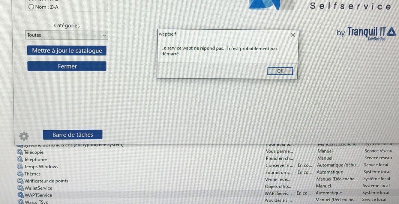

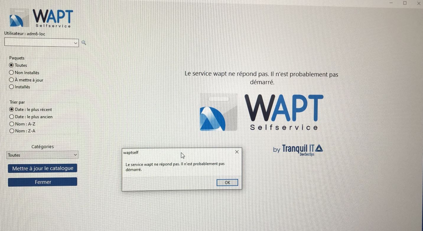

On the machine in question, when launching Wapt Self Service, I get the message "The Wapt service is not responding. It is probably not started."
I have therefore checked the Wapt service, and it is indeed started; I can stop and restart it manually (screenshots attached).

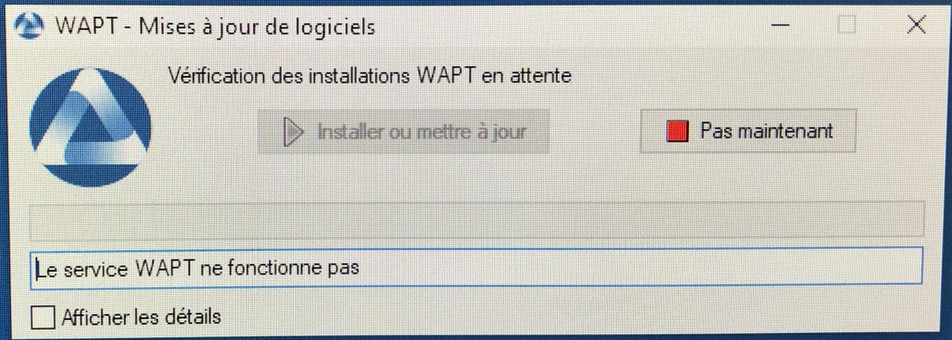

If we shut down the workstation, Wapt informs us that the "Wapt service is not running" (screenshot attached).
