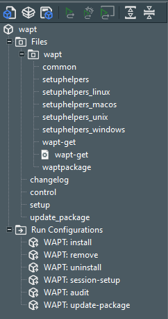

Indeed, that must not be the correct command being used. I'm using PyScripter and I only have this:
In my Run Configurations I don't have a build-upload option.

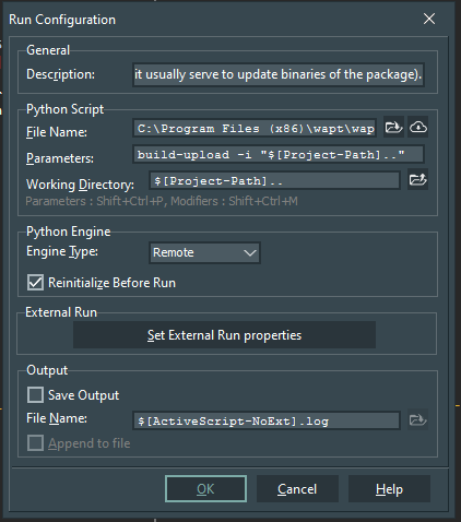

So I did a Run Configuration like this, with a build-upload -i to increment the package version:
And when it starts, it doesn't prompt me with a popup to enter my private key and then the console password:
I'm not really sure what I did to my console.

Hi Mathieu,
we had quite a few calls regarding the build-upload feature in PyScripter due to the different execution contexts and authentication options [1]. We've removed it, and the new method is simply to have a console open and drag-and-drop the package onto the private repository (or to enable the package development tab in the view and use the functions there).
