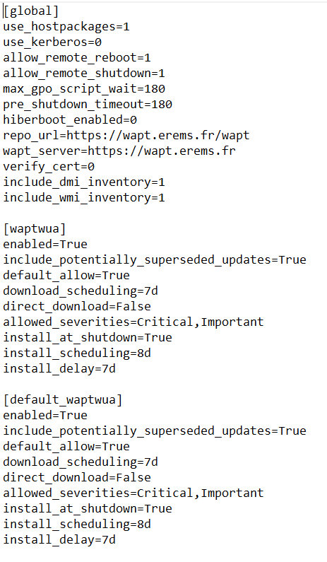

We are experiencing a problem with Windows updates on some WAPT agents.
WAPT is version 2.5.5.15697. The agent configuration is as follows:

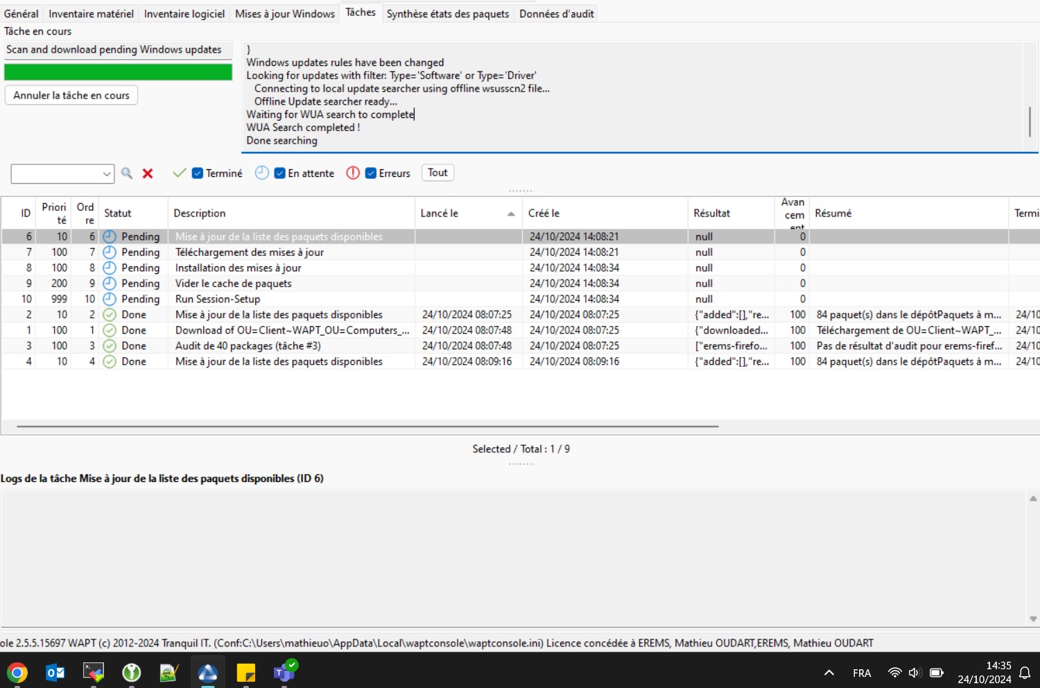

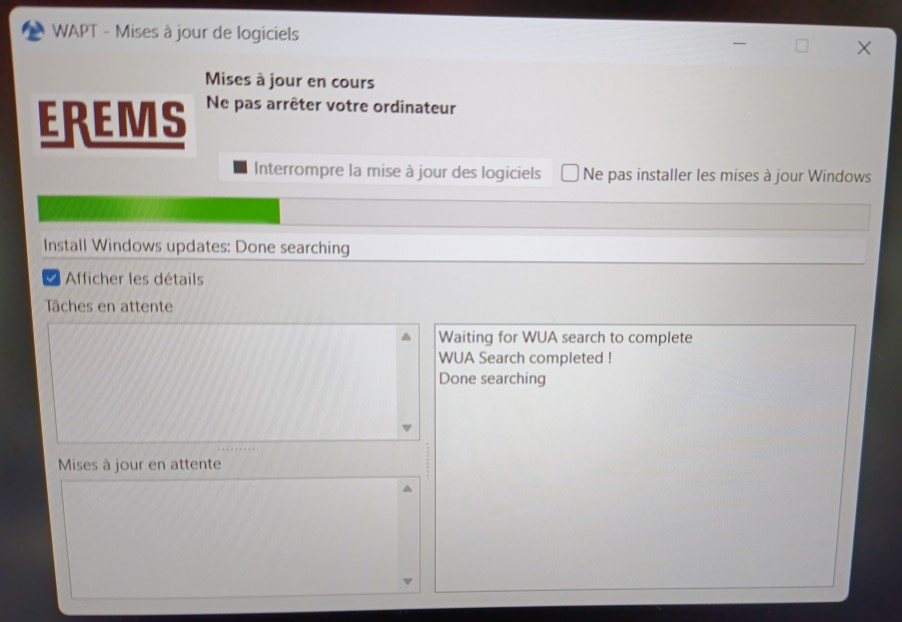

During a scan for Windows updates on the agent, the WAPT Exit never completes:
(He was found in the same condition the next day.)
The console displays the same thing:

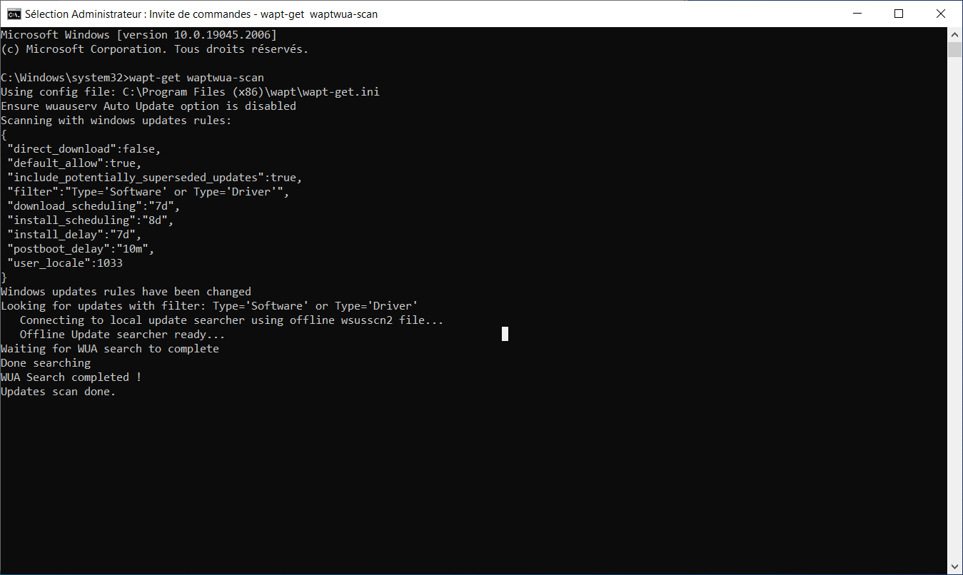

And if we run "wapt-get waptwua-scan", it doesn't return control either:

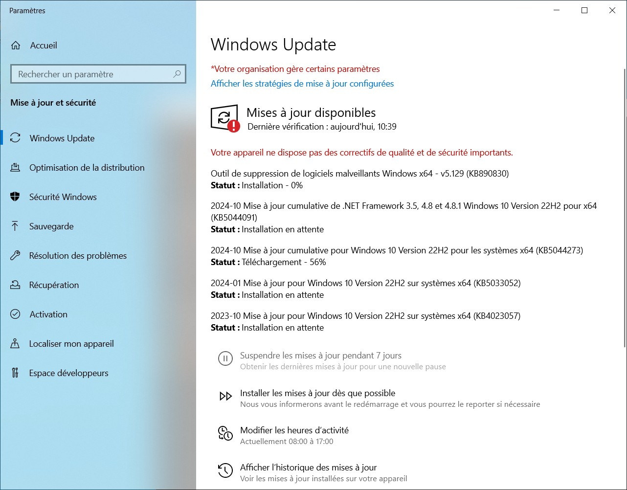

Finally, if I go to the Windows Update panel in Windows, it does see updates to be installed and installs them:
It doesn't seem normal to see the updates in this location when WUA is supposed to be enabled.

Messages: 2380
November 13, 2024 - 4:00 PM
Hello
, could you try removing `include_potentially_supersed_update` and setting `
include_potentially_supersed_update=False`?

November 25, 2024 - 11:26
since the setting was deployed, the situation seems to have returned to normal. I haven't noticed any other issues, and on the console side, WUA is back to green everywhere.
