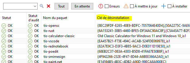

- WAPT Expert
- Messages: 2380
Note that this feature only works if the key that appears in the software inventory is present here on the package
, and it corresponds to what was added to the uninstallkey variable during installation.

- Capture.PNG (22.5 KB) Viewed 8350 times
I just upgraded to the latest version of WAPT. And indeed, my software inventory is working again.
The feature works perfectly with packages that have the uninstallation key directly in the variable. Thank you very much for this clarification.
Everything is working on my end; thank you for fixing my problem.
