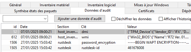

In the audit data, is the Rustdesk ID the same as the one you use manually?
The rustdesk mac package is installed correctly on the Mac but I have nothing in audit data (no line with Rustdesk).

Audit data from a PC where Rustdesk/Wapt is working correctly: Audit data on a Mac where Rustdesk/Wapt is not working:
