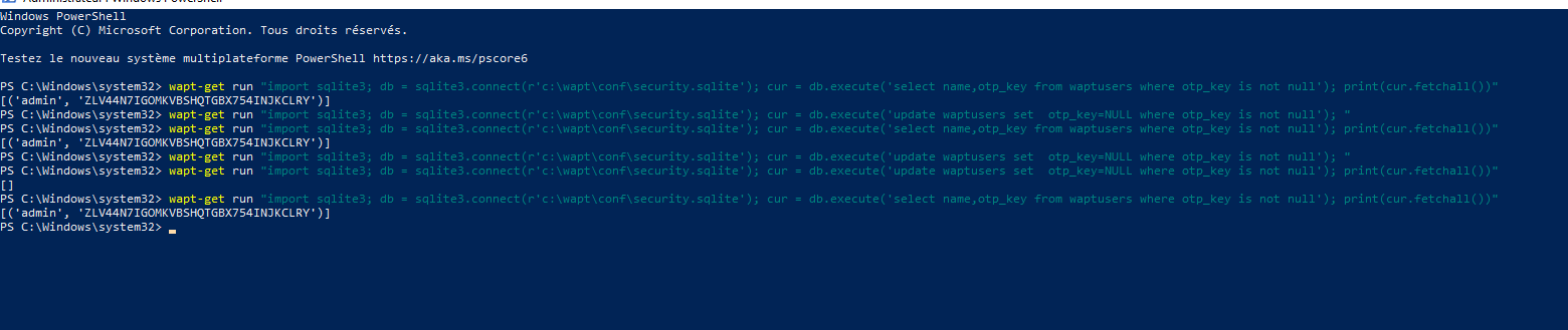

This one would be best for a WAPT Windows server:
Have a good weekend,
Bertrand
Code: Select all
wapt-get run "import sqlite3; db = sqlite3.connect(r'c:\wapt\conf\security.sqlite'); cur = db.execute('select name,otp_key from waptusers where otp_key is not null'); print(cur.fetchall())"Bertrand
oops :
Code: Select all
wapt-get run "import sqlite3; db = sqlite3.connect(r'c:\wapt\conf\security.sqlite'); cur = db.execute('update waptusers set otp_key=NULL where otp_key is not null'); "add a db.commit();
after the SQL update query
Code: Select all
wapt-get run "import sqlite3; db = sqlite3.connect(r'c:\wapt\conf\security.sqlite'); cur = db.execute('update waptusers set otp_key=NULL where otp_key is not null'); db.commit();"Tranquil IT
