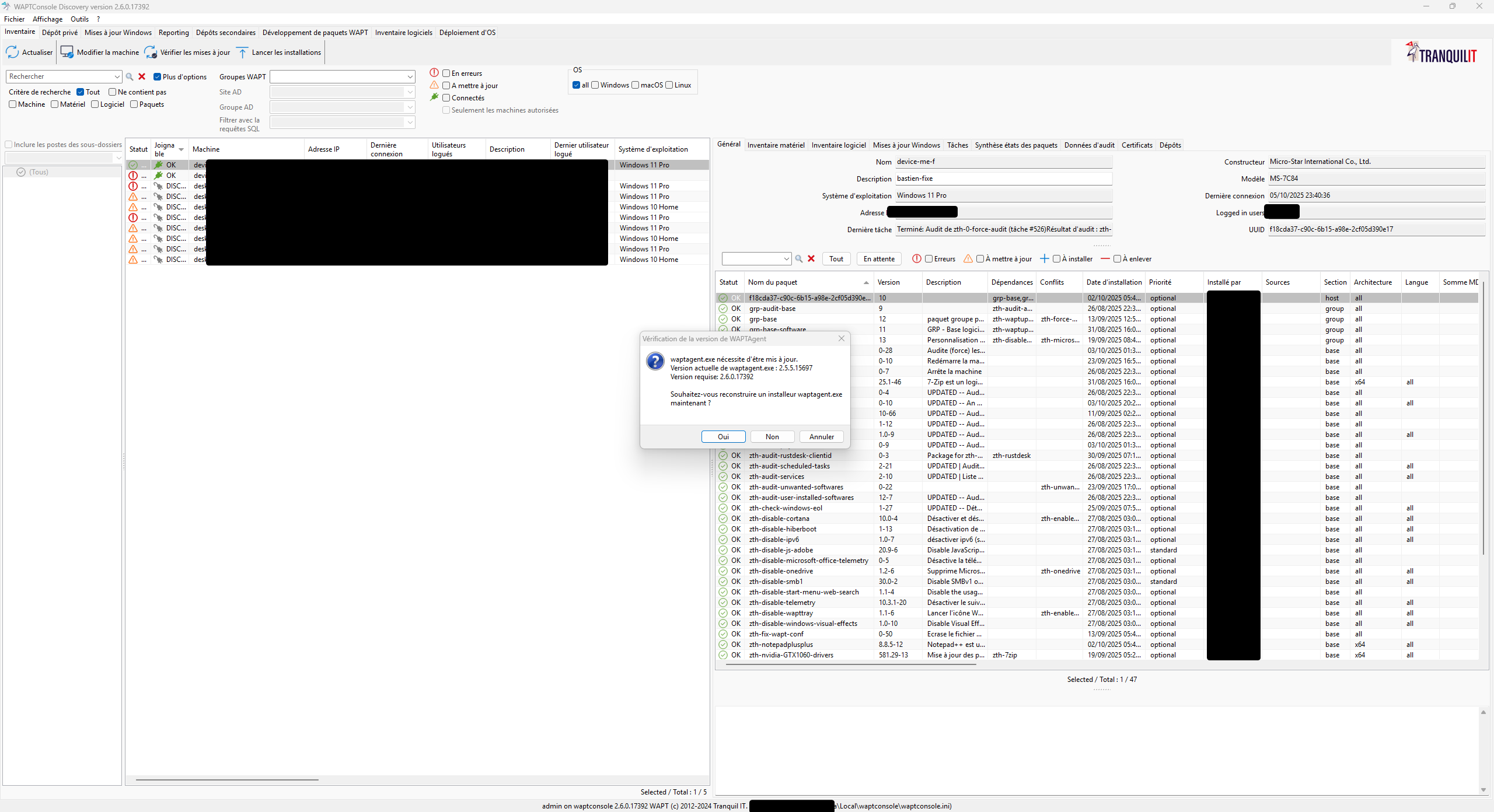

and (after waptsetup -> install -> open console) upon restarting the console, a small relief:
However, apart from my admin position, all agents are on 2.6.1 (so n+1) but everything seems to be working (inventory / update / install / waptexit / etc)
