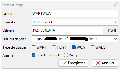

, could you please provide details of the rule that was created?

- WAPT Expert
- Messages: 2380
The rule only mentions wua, so it won't be very visible on the client side.
You'll mainly see it if, for example, you delete wsusscn2.cab from a machine and the machine re-downloads the file.
You can also verify that downloads are indeed going through this repository by looking at the audit data:
host_metrics - peercache.
In the URLs, you'll see the source URL.
