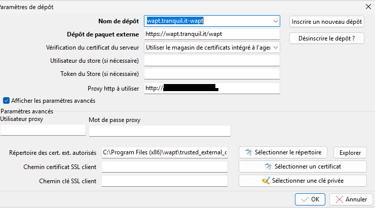

We recently purchased the enterprise version of WAPT.
I'm trying to access the Tranquil IT repositories from the WAPT console, but without success.
On the server side, the Tranquil IT domains are responding correctly on port 443 (whitelist set up on our Squid proxy).
Whitelist:
.tranquil.it
.wapt.fr.
I'm getting two errors, which I've attached.
WAPT server OS: Ubuntu 24.04.
Console installed on a Windows 11 PC.
Thank you for your help,
Joshua

Hello Joshua,
In the first screenshot (THttpClientSocket.OpenBind), it should indicate the proxy if it is being used when there is a proxy error, see the example below:
Clipboard - May 27, 2026 10_51.png (8.61 KiB) Consulted 10643 times
So apparently the proxy configuration line you indicated was not taken into account.
Is this in the correct form? http://proxy.mondomaine.lan:8080 ?

Hello Denis,
I configure the proxy as follows: http://ip_server:port.
I don't enter an ID or password.
Best regards,
Joshua

Hi Denis,
I saw your message.
I also checked with our systems team; the configuration hadn't been done on the correct server.
Everything is okay now, we can mark the issue as resolved.
Thanks again,
have a good day and a good weekend.
Joshua
