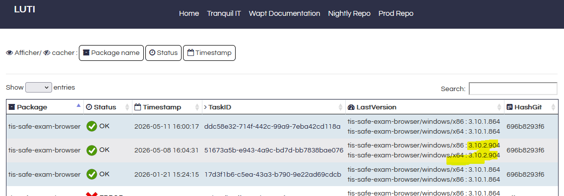

Indeed, SafeExamBrowser has removed version 3.10.2 online, along with the warning in question. The 3.10.2 package has been removed from the online version.
In fact, Luti had indeed noticed the change [1] between 2026-05-08 16:04:31 and 2026-05-11 16:00:17:
But it happens quite rarely and we have not yet put in place an alert mechanism to analyze the reason for the rollback and act accordingly (apart from the antivirus analysis usually done by Luti).

Thanks for the feedback
