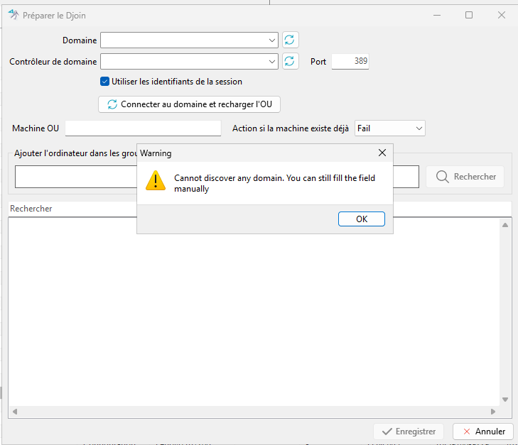

thank you for your reply. It works, but it's a shame it no longer works with the "more options" box checked.
However, I still have my AD problem; when I try to deploy with WADs, it can't find the ADs.
Have a nice day.

- Attachments
- The domain cannot be found to embed pc.png (26.97 KB) Viewed 1408 times
- WAPT Expert
- Messages: 2380
Could you clarify the action?
Are you clicking on the small arrows next to "domain"?
Otherwise, as the message indicates, you can manually enter the domain name.
