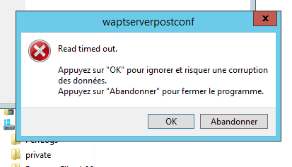

WAPT server OS: Windows Server 2012.
I upgraded from version 1.5 to version 1.6
. I'm encountering a problem during post-installation configuration: `read-timed-out` after entering the server access password (see attached image). I don't dare proceed further because of the message...
What have I missed?
Thanks in advance.

I am in exactly the same situation as PPE.
upgrading from version 1.5.1.26 to 1.6.2.7.
My server OS is Windows 2012 R2.
Do you have a solution?

The problem seems similar to the one discussed in the thread viewtopic.php?f=13&t=1481.
The WAPTserver service is shown as paused. It does not restart.

I have the same problem on a 2008 R2
I even uninstalled Wapt, but it didn't change anything

Problem solved following sfonteneau's post on this thread: viewtopic.php?f=13&t=1481
The solution:
Create a
code: Select all
net stop waptserver
net stop waptservice
net stop waptnginx
sc delete waptserver
then restart the installation
THANKS.
