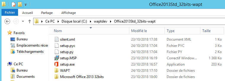

Further to my previous message, I would like to clarify that the fact that I specify the full path to setup.exe:
Code: Select all
cmd = '"C:\waptdev\Office2013Std_32bits-wapt\Microsoft Office 2013 32bits\setup.exe" /adminfile "setup.msp"'
This is because if I put setup.exe by itself, I get a message telling me that setup.exe is not found.
For your information, here is the directory structure of my package:
The setup file is in the root directory, and I've also copied it to the WAPT folder and then to the Microsoft Office 2013 32-bit folder. So I'm having a little trouble understanding where the working directory of the Python script is... could someone please help me? :)
Could the fact that the path is hardcoded in the script be generating the above error?

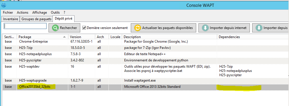

Furthermore, to try and be as thorough as possible, here is my package displayed in the console:
I get the message when I right-click on a host / Add a dependency / I check the package and then I click on launch installations.
(I'm mentioning this in case I make a mistake) :) )

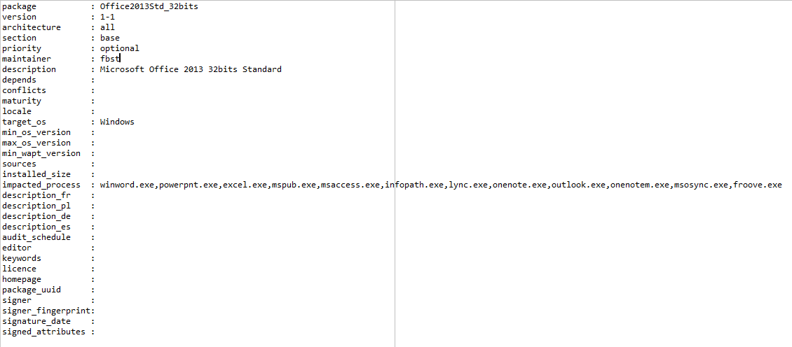

Finally, here is the package's control file:
Thank you so much... have a good evening

The files setup.exe / setup.MSP / silent.xml are located in the root of the office package along with setup.py and all office folders.
