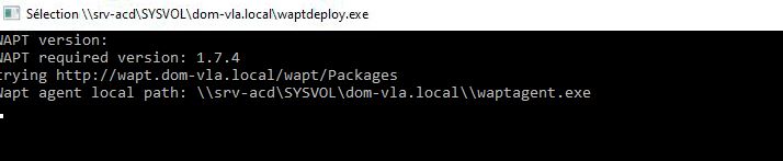

I'm sending this email because I'm stuck
For some time now I have been updating the wapt server, then I generate a new agent, and I copy the hash into the gpo script.
And nothing works.
When I launch the waptdeploy installation directly on the machine, I get this message. I've already changed the server name; it's now srv-wapt instead of wapt (already a bad start). I can see that it's the correct path, but I have a double backslash at the end
wapt deploy.JPG (22.8 KB) Viewed 5131 times

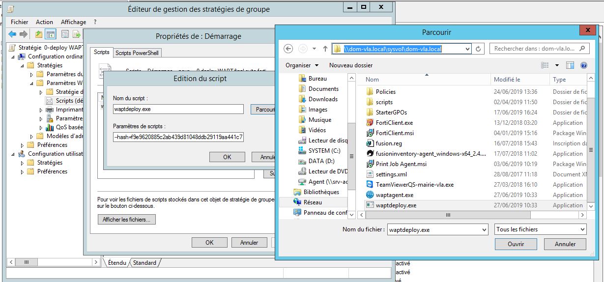

here is the GPO in question
wapt deploy1.JPG (146.52 KB) Viewed 5131 times

Could you please tell us the command line you are using in your GPO?
