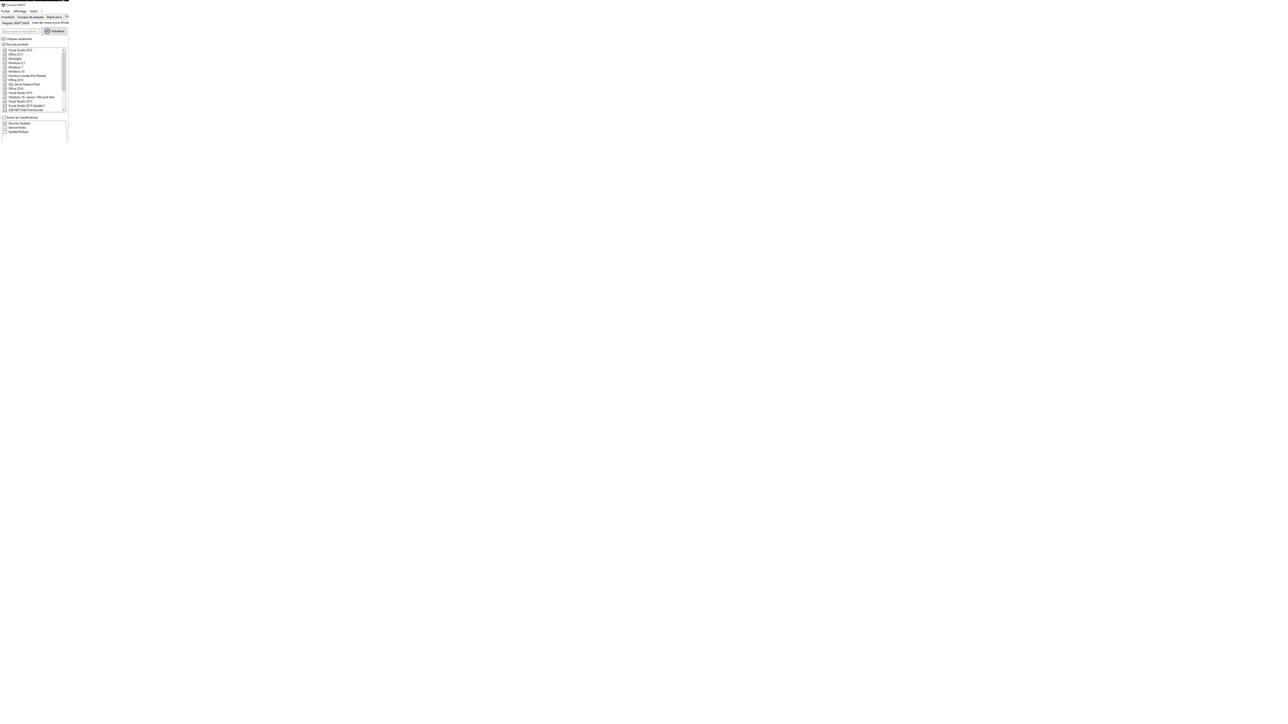

1) Knowing that we only want to install critical and security updates on our client PCs, and that we have configured the filters "Critical only", "All products", and "Security Updates" below in WAPT, are these the only filters necessary and sufficient for what we want to do?
I'm asking because the labels on Wapt are different from those on WSUS. See attached screenshot.
2) The "Pilots" and "Pilot games" classifications do not exist on Wapt. Why?
3) To generate an agent in Wapt, what exactly does the "Allow all updates by default" checkbox do?

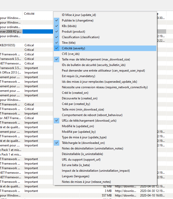

- WAPT Expert
- Messages: 2380
Actually, with "allowed_severities" you allow KBs with the severity level specified in the parameter.
In WaptConsole, this is the criticality column.
There's also the allowed_classifications parameter, which corresponds to the "classification" column, but this parameter is neither documented nor tested
- Attachments
- Annotation 2020-10-30 094019.png (79.17 KB) Viewed 6888 times
So with the configuration currently available on Wapt, I don't have all the critical and security updates?
See the attached file, it's a screenshot of the configuration in question.
