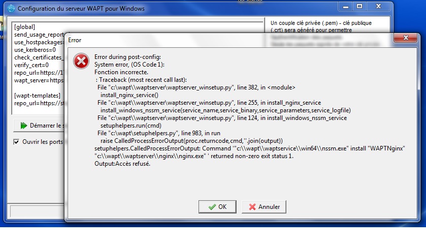

When I try to open the WAPT console, I consistently get an error message and it is impossible to open.
I've attached a screenshot.
Could you please tell me how to fix this problem?
Thank you in advance for your help
Crash when opening the console

Based on the screenshot you attached to your message, it appears that you are installing the Windows version of the WAPT server, and not the WAPT console.

Do you have User Account Control (UAC) enabled? Has the nssm.exe file you mentioned been "eaten" by a greedy antivirus program? Do you have something already listening on port 80 or 443?
