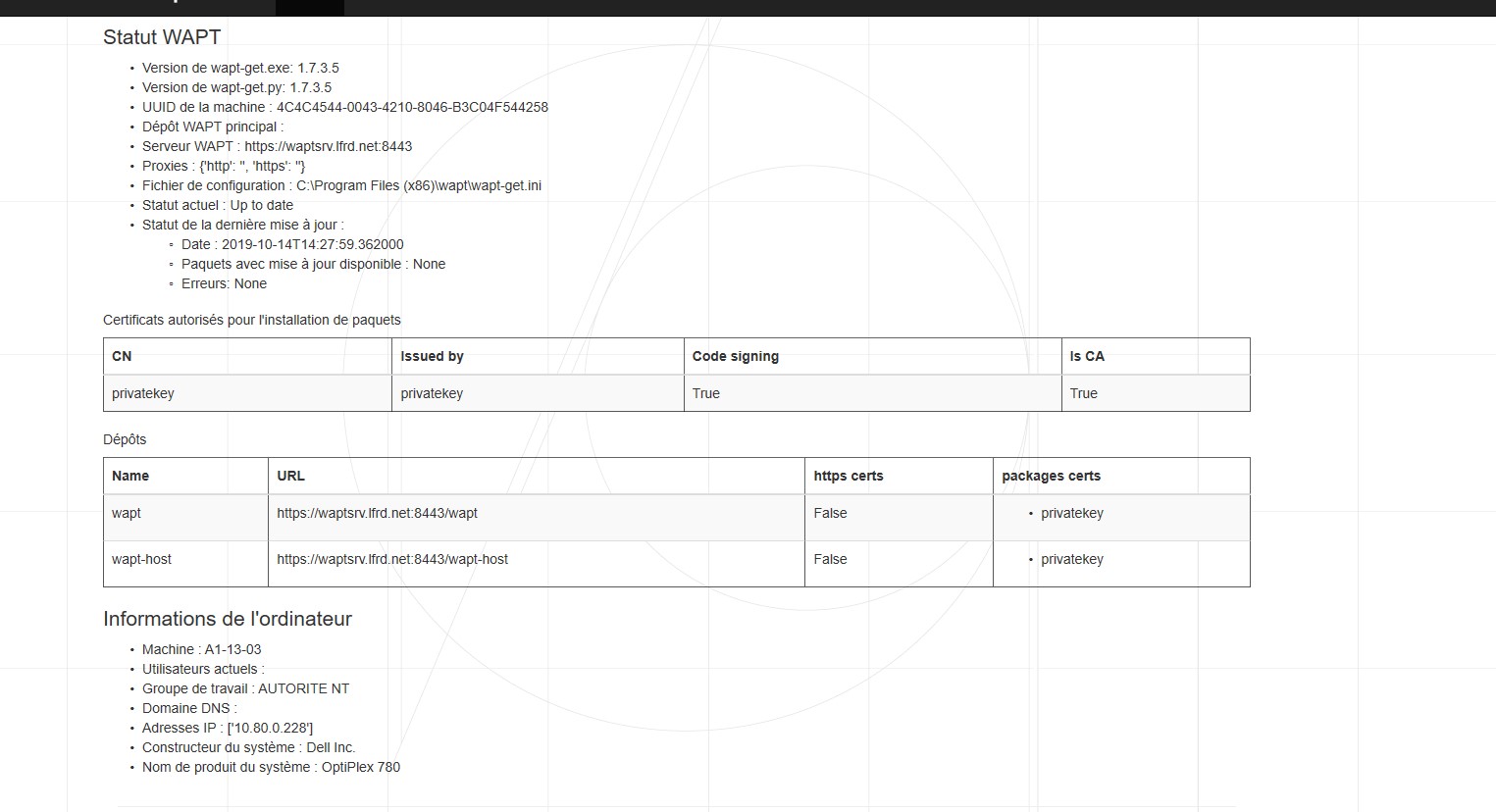

October 14, 2019 - 9:40 AM
Yes, here is the status on the post:
Thanks again!

I'm referring to this link:
https://waptsrv.lfrd.net:8443
PierreM
Messages: 13
Registration: May 1, 2019 - 03:39
October 14, 2019 - 11:01
Indeed, they don't have access.
Thanks for the suggestion; could it be a DNS issue on that subnet?
Messages: 2380
October 14, 2019 - 11:36
Port not open, or DNS or routing issues.
You need to perform the usual diagnostics: ping, nslookup, telnet, etc.
