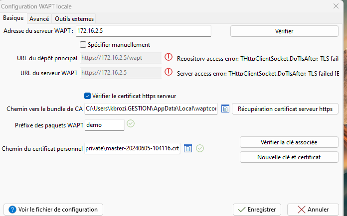

I had to reinstall the WAPT server, but I'm encountering a problem when I try to install an agent: the nginx service is not found.
Can you help me?
Thank you.

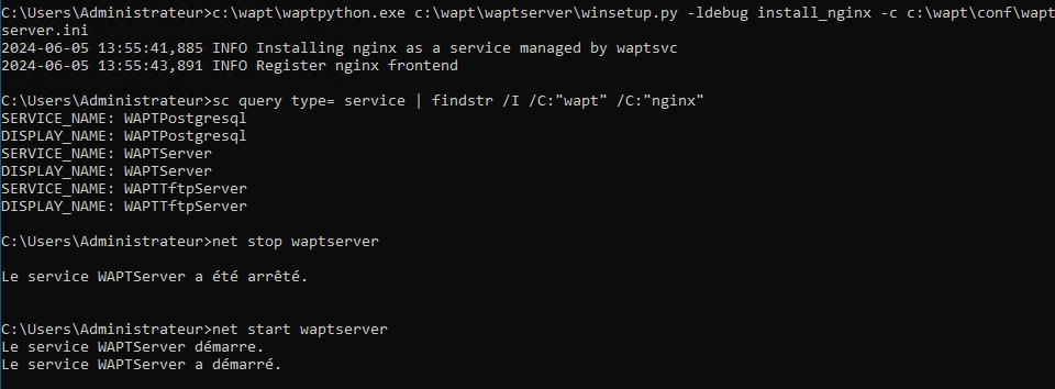

Could you try running this?:
c:\wapt\waptpython.exe c:\wapt\waptserver\winsetup.py -ldebug install_nginx -cc:\wapt\conf\waptserver.ini
then restart the server

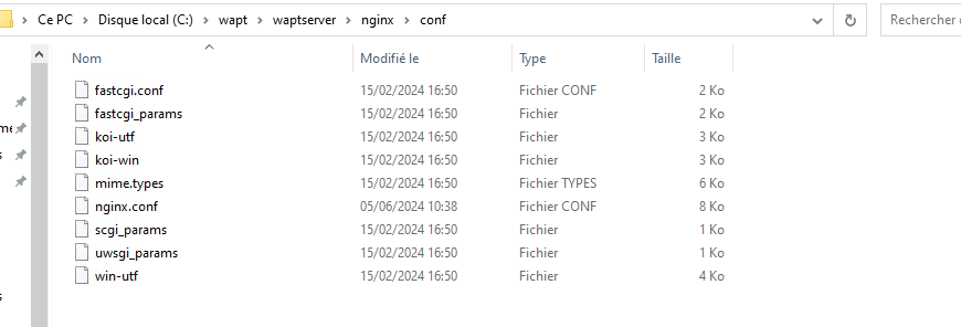

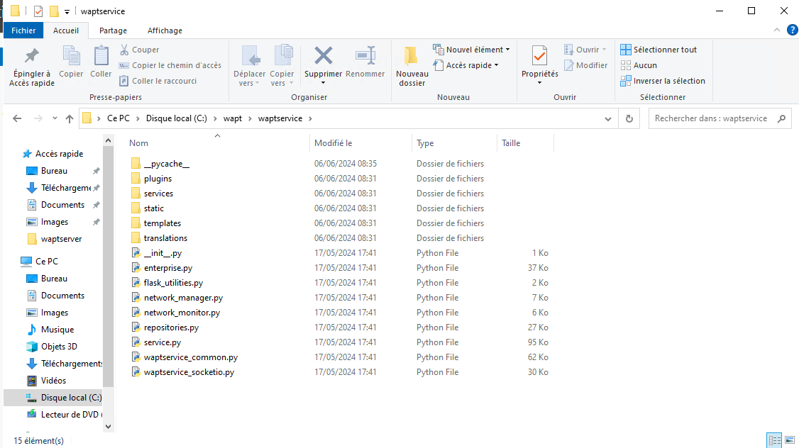

Do you have anything in:
C:\Program Files (x86)\wapt\waptservice\nginx\conf?
or in
C:\wapt\waptservice\nginx\conf

Contact our support team directly by phone.
Your nginx configuration appears to be incorrect even after restarting the service installation.

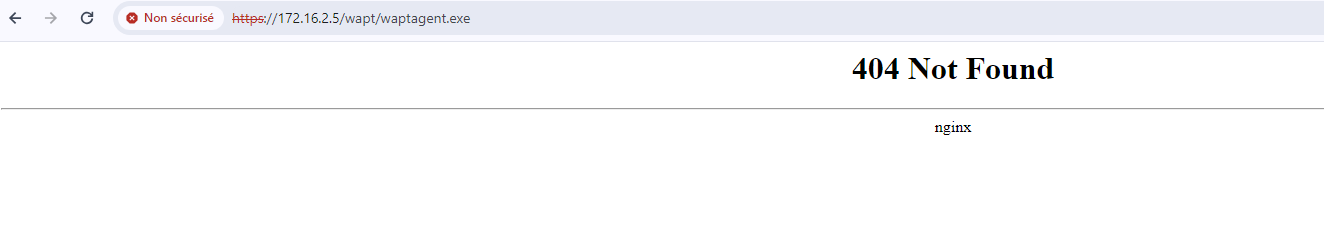

Seen over the phone.
It's normal that the Waptagent doesn't exist on a new installation. The procedure is therefore the same as for a fresh install.
However, the server was reinstalled, and the old HTTPS certificate was lost (and not backed up).
We therefore regenerated a correct Waptagent. It will then need to be redeployed across the network via Group Policy.
